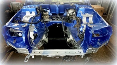

Yes, it is R25 V6 Turbo with Z7U engine, 182hp. It is 433rd exemplary that left Sandouville marked as 25.
Once during our Youngtimers club event I looked under bonnet of Delorean and got interested about the engine. So I found out that R25 also had it too. At that time I was searching for something around 30 years old with good power. To have fun of renovation and to drive our regularity rallies for Historic class.
So in my eyes came this model and fortunatly I found two of them - make one driving. I am not mainstram men - therefor I liked to choose Renault (in our country everybody is fun bmw, audi, mb...).
I work fanatic on this car already second year. The body is renovated, suspension new, brakecirquits all new, seats renovated. Now I am at the engine workshop. One experienced motorist will help me, but before I am renovating several periferial elements and searching for parts to be replaced.

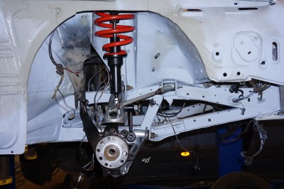

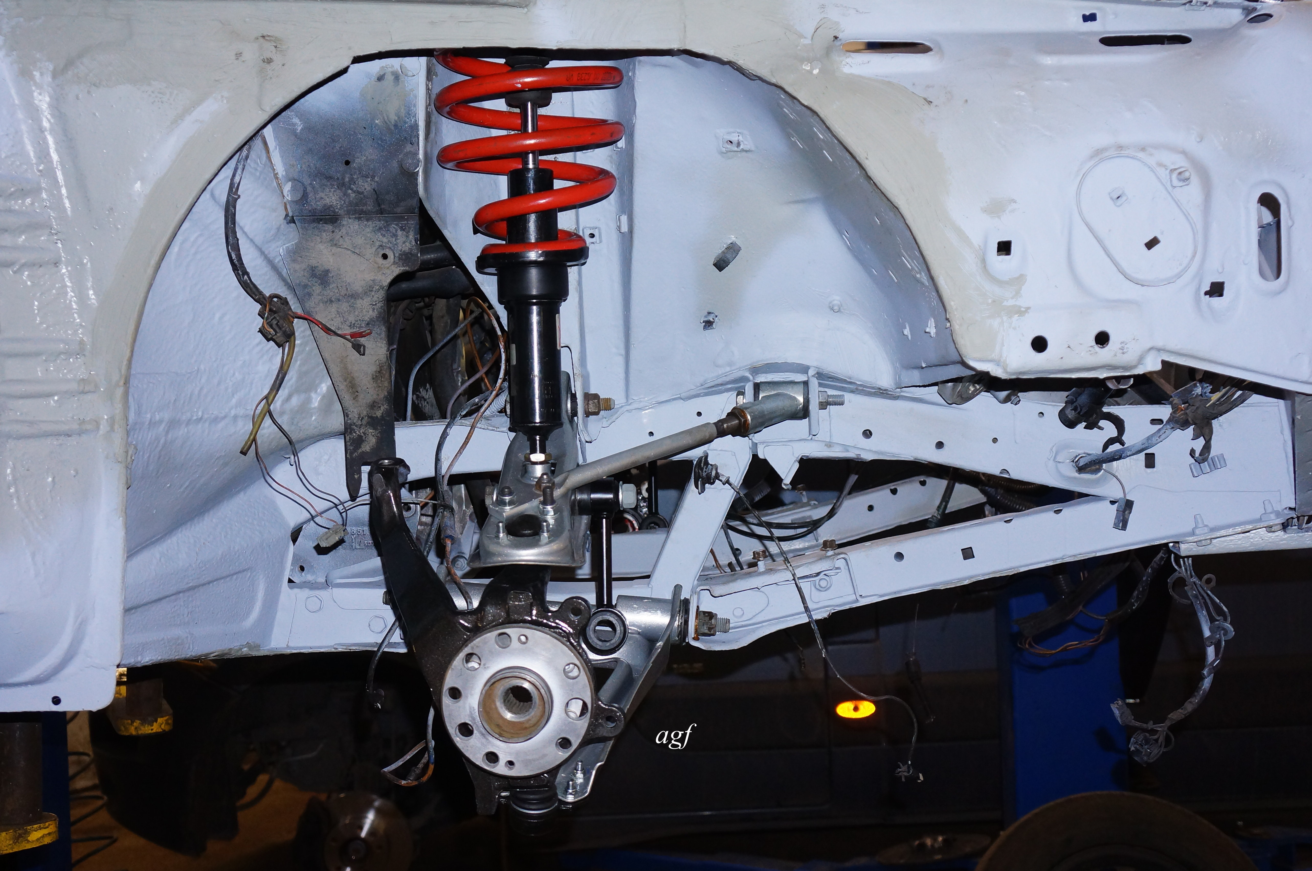

What I noted very interesting - is the tool you`e got for replacement of front springs. I did it in very complicated way - pressing springs before and locking with belts, then putting on place in car and cutting slowly the belts of with knife.

The tool required for the front spring is specific. But there is another tool that make the job: Facom has a spring compressor that works well ! I don't recommend to use another way or another tool to unload the springs (it may cause death)
